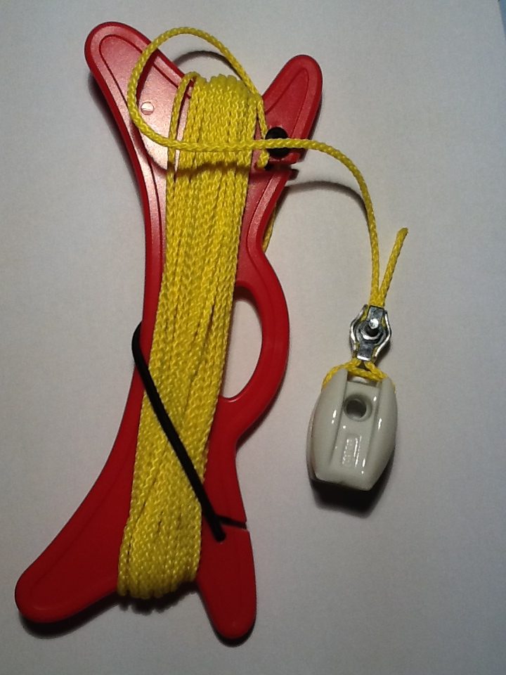

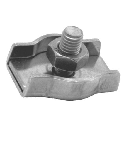

The actual antenna’s physical construction is fairly standard. I used standard ceramic end insulators (one at each end), with 10m-braided nylon rope and small wire rope clips to attach the wire and the rope to the insulator. For simplicity, I picked speaker wire with 1.5mm square diameter stranded copper. It is suitable for temporary installations, but I would not use it for permanent construction, of course, as the copper wire will rip and the plastic coating will not withstand weather conditions (ultraviolet rays will harden it and crackle). Also metal parts in permanent installations will rust unless coated properly. Keep in mind this is a portable antenna for temporary installations.

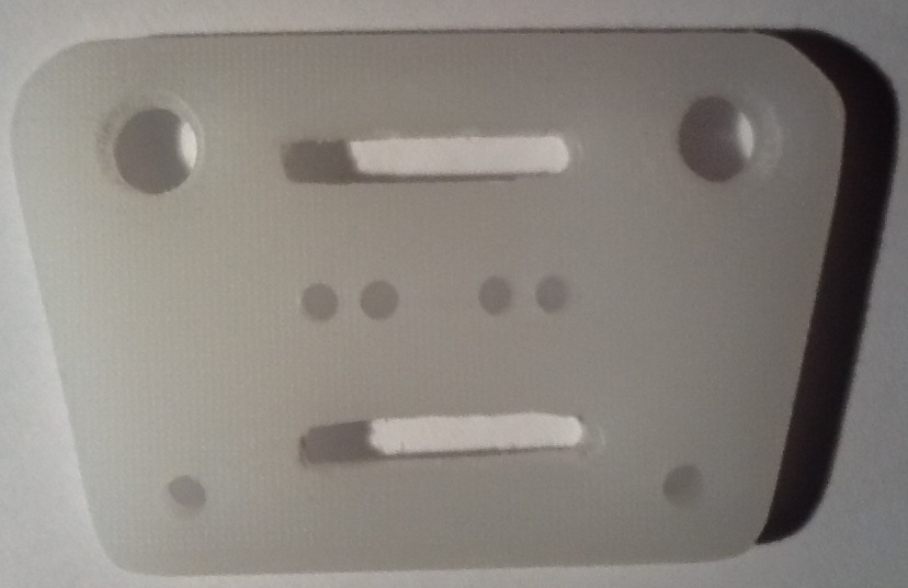

Home made center insulator
The center insulator is made of a household cutting board, which is made of high-density polyethylene (HDPE). It is very easy to work with and it does not add much weight to the installation. This is the final assembly of the center insulator installation:

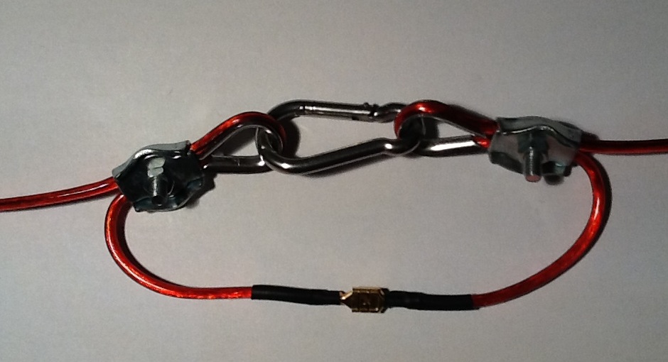

The following picture depicts the non-standard part of the antenna assembly, the practical implementation of its extendability. The original idea came from Tibor OK2GM, who gave me the idea of using carabiners, metal loops with spring loaded gates and also stringing antenna wires together using of connector lugs. This modification of the antenna makes it very easy to disconnect or to open up both sides of the dipole and insert a section to extend it to 160m. See the construction of the extention in the following picture.
If the connector lugs are unplugged and the carabiner is openned, the antenna wire may be interrupted and an extra wire may be attached to extend the lenght of the antenna wire.
