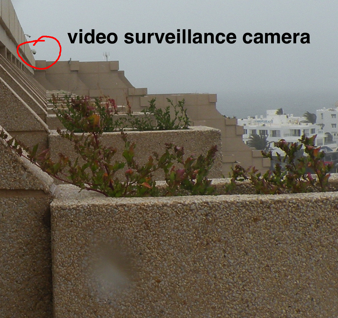

Installing an antenna in a hotel is quite a different experience. I found out the hard way, that an EFHW antenna is hardly ever suitable in a hotel environment. It requires a fixed distance between one end and the other end of the antenna, even with rope extension. In one instance, there was not a single tree nearby the hotel to hang the antenna. After two similar failures to operate from a hotel room, I decided to search for a better solution. After all, I cannot allow failure in Lanzarote.

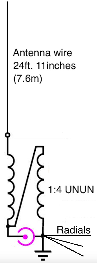

After a careful search, I found the Rybakov Antenna [3] that appealed to me. It seemed very simple, a 24 ft. and 11 inches long (7.6 m) vertical radiator with a few radials, an easy antenna to build, while it may be relatively invisible to the eyes of the hotel staff. I bought a 35 ft. telescopic pole that I can fix to the railing of a balcony with bungee cords; throw the radials on the floor of the room and Eureka.
What is a Rybakov Antenna? Even after an expanded search on the Internet, I could not find credible origin of this antenna; however, incidentally I picked up a book about Stealth Antennas [4] authored by Steve Nichols describing exactly this antenna. The author says, Rybakov in Russian means “family of fisherman”, and it is so called because it uses a fishing pole-like rod to hold the vertical wire.
According to what I discovered, the Rybakov antenna is essentially a vertical antenna, that is not ¼λwavelength, but designed to be non-resonant on all of the HF bands, hence its magic height. It requires a 1 to 4 unun [5] and an antenna tuner to tune up.

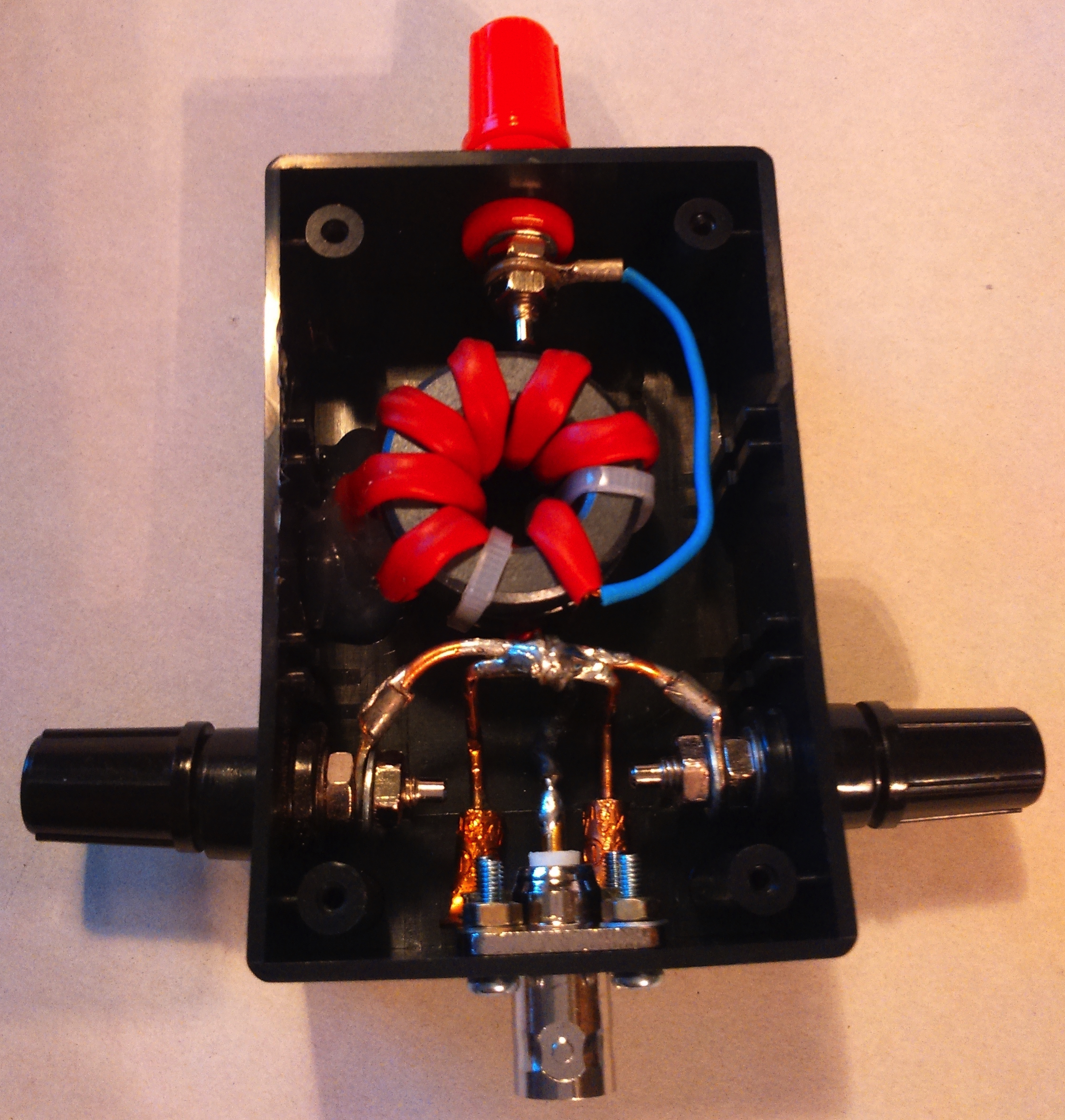

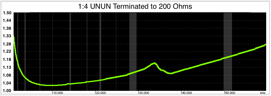

I constructed the 1:4 UNUN first. Even if the antenna does not prove to be a success, the UNUN will be useful for other projects. I measured a few ferrite toroids laying around in my drawers. I do not use iron powder toroids anymore, since I read one of Sevick’s books [6]. He said, the coating reduces their effective permeability making them inappropriate for broadband transformers. He also stated that their low AL value requires too many turns, leading to copper losses.
How to measure the AL value (inductance factor), and the initial µ0 (initial permeability), is a subject of another article, so I am not going to get into details here. I located a ferrite toroid with 1.1-inch (2.9 cm) outer diameter, more than enough for the relative low power operation with a KX3. I determined that its parameters are around AL = 450 and µ0 = 550. It is somewhere between ferrite material 61 and 43. I wound seven bifilar turns of enameled wire, protected by an insulating tube on the toroid, and then measured its SWR. As the diagram shows, it is quite low across the entire HF frequency spectrum. For my intended band usage: 40m, 30m and 20m, the SWR is under 1 to 1:04. I could not expect any better than this.
I installed banana plug receptacles on the plastic box, so it is very easy to connect the antenna wire to the red and radials plugged into the black banana receptacles. I cut two about 24 ft (~8 m) radial wires. They were not cut to resonance, since they will lie on the floor, whichever way they fit in the hotel room.

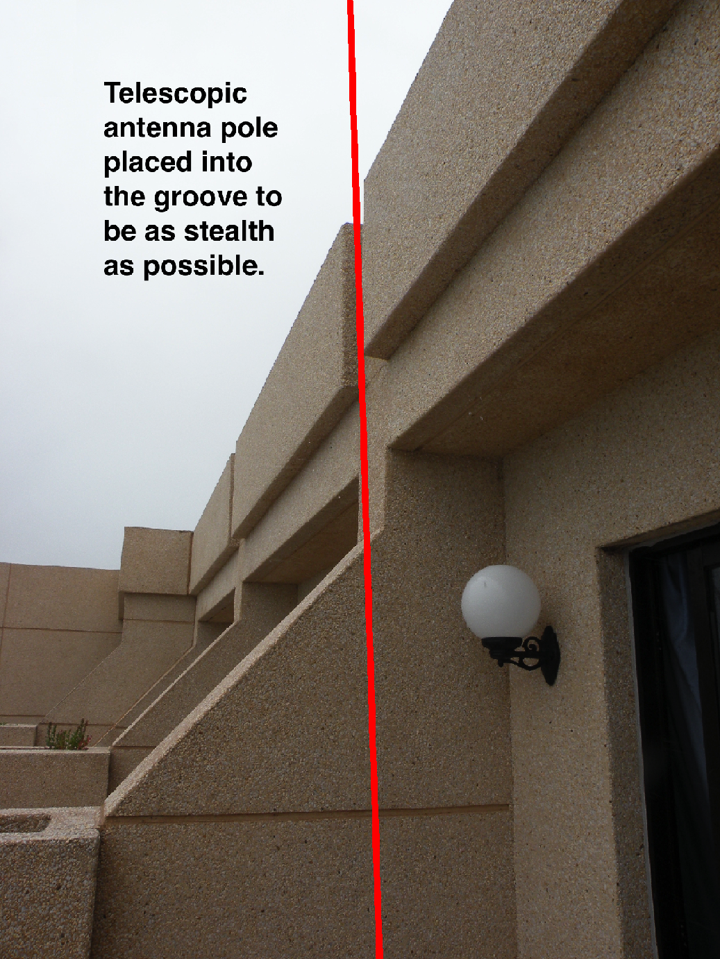

I ordered a 33ft (10 m) telescopic mast from SotaBeams [7]. The collapsed mast is 26.5 inches (67 cm), easily fitting into a sizable travel bag. It weights only 2.9 lbs (1.3 kg), perfect for travel. You may use any suitable masts, of course; however, it is important that the mast does not contain carbon, which is electrically conducive material. A cheep fiberglass-fishing pole will do just fine.

The second day after settling in the hotel, I surveyed the balcony and the surroundings for the placement of the antenna. To the left of the balcony was a video surveillance camera, so I decided to install the pole in the evening, perhaps the camera’s vision is reduced, as well as nobody will be outside the hotel grounds to see it. The right side of the balcony had a grove on top of the building side, where I could slide the antenna pole to be out of the sight of the camera. The following pictures demonstrate the placement of the antenna; however, I could not take pictures during the evening, therefore it is only illustrated with a red line.
Soon I set up the rig, tuned the antenna for 40m, and searched for activity. I could hear one or two fragments of calls, but the band was essentially dead. I started calling CQ EA8/HA5CLF. After long repeated calls, VK3HJ called back. I received a 569 report. Then after a few unsuccessful exchanges, such as HA5TB and YT1N (they faded away and the QSO was incomplete), IU5ASA returned my call and I received a 589 report. Another NIL for IK6RFQ, but then UX5UW gave me a 589 report. I thought it was quite good for a start.
The next day I produced UY5VA and HA8SSG both with 599 reports. However, besides these two QSOs, I was not able to hear anybody else even though I diligently kept calling a CQ.
