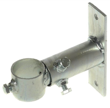

Figure-2: I purchased two of the above brackets to attach to the wall and hold the antenna pole.
The brick wall is 14cm (5 1/2 inches) thick, so it will hold the pole very firmly. I will be able to put various antennas on it in the future, such as a Gap Titan, but for now let’s talk about the Random-Wire LDG RT-100 remote tuned antenna erection.

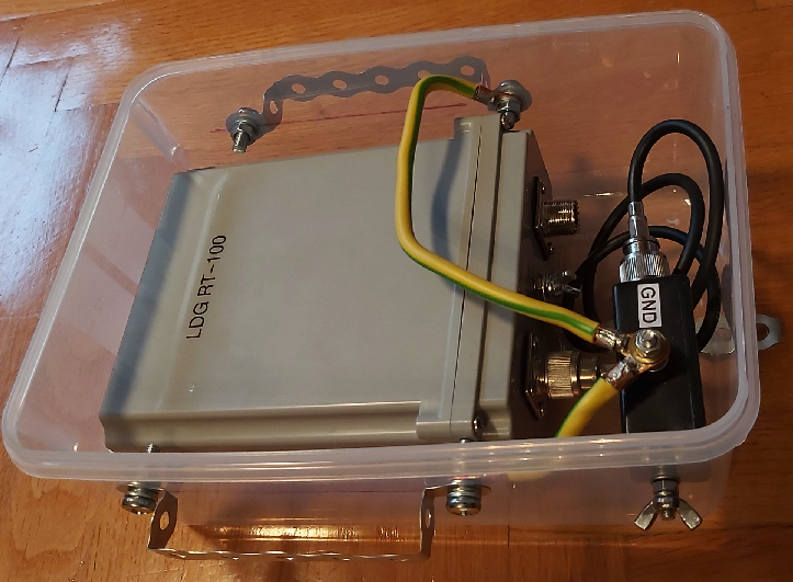

Next, I constructed the tuner assembly. Although the LDG TR-100 is a waterproof unit, I decided to protect it from the elements anyway. I purchased a Tupperware container large enough to hold the antenna tuner and a 1:9 balun.

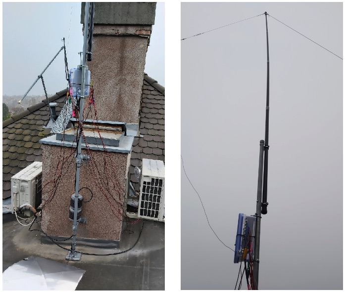

Figure-3: Finally, after the assembly of the remote tuner box and the construction of the holding structure, here is the final look of the antenna.
Figure-4/5: A closer look at the tuner assembly and radials is shown next

The next picture shows the antenna wire from the top of the roof of my condo to the top of the roof of a very friendly neighbour.

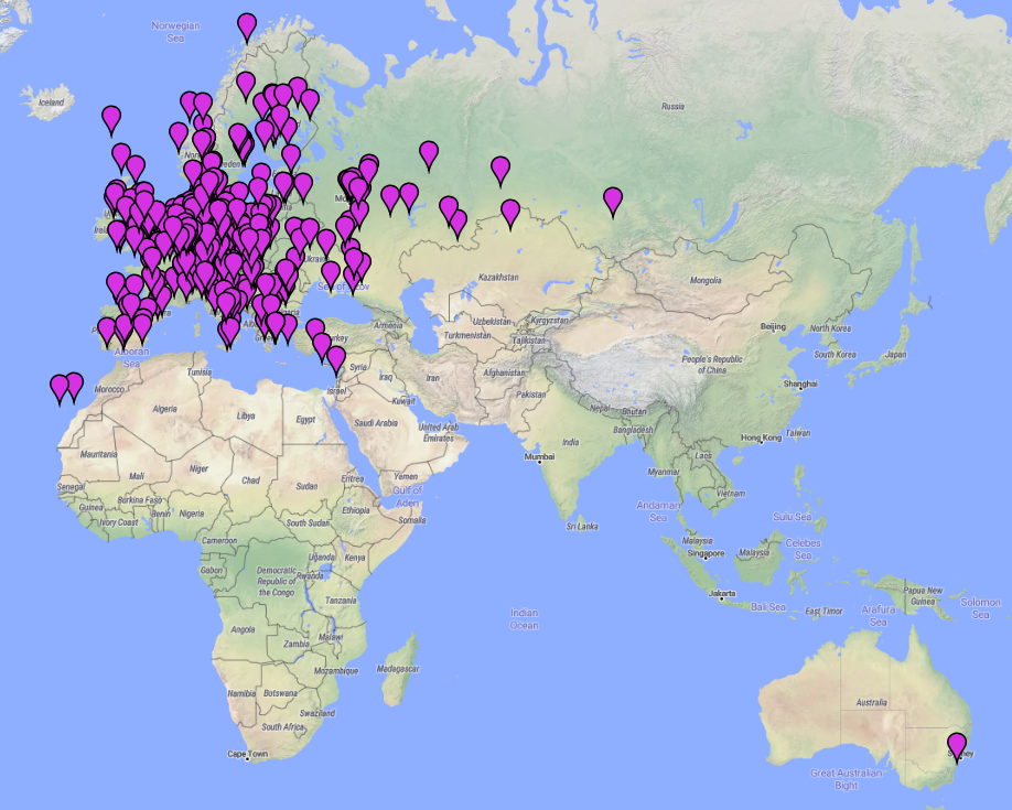

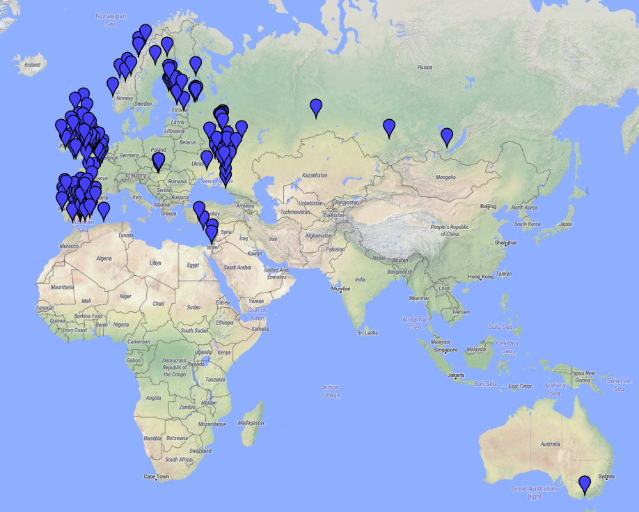

What are the results? Well, I conducted some limited tests. It tunes up fine from 80m to 10m bands. I also performed some tests with FT8. See the 80m and 40m band results.
This is 80m band in the evening for about 10 minutes of CQ-ing and making a few QSOs. The SFI was 82 and the k index 1.

This is 40m band in the evening for about 25 minutes of CQ-ing and making QSOs. The SFI and the k index was the same as above of course.
Figure-10
