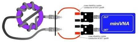

For completeness here is the way to test the common mode choke:
This is from link. It is worth checking out this site, it gives you a lot of measurement techniques using the miniVNA.

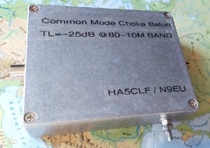

But, before I present my measurements, here is the choke balun with the enclosure, this time with both BNCs insulated from the enclosure:
By the way, I used BNCs instead of SO-239 connectors, since I could not figure out an easy way to insulate them from the box.

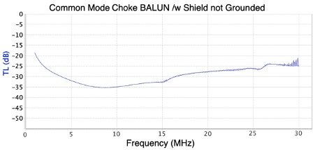

My initial measurement with one of the BNCs grounded showed the TL value degrading rapidly above the 20m-band. However, both BNCs being shielded from the enclosure, it improved the choke balun immensely, see the result:
This needs an explanation. What do I mean by „/w Grounded Shield”? As I said, the two BNCs are insulated from the aluminum enclosure, however, the enclosure is now grounded to the miniVNA common ground. If it is not grounded, the measurement results are nothing far away from this measurement above, see next:
It just becomes a bit jittery on the higher end of the spectrum without the ground. Nevertheless, note that the transmission loss essentially reaches below -25dB from approximately 80m to 10m-bands on both diagrams.

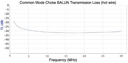

For the sake of curiosity, I also measured the hot lead of the coax for transmission loss:
Essentially it is the same curve as the measurements on the shield of the coaxial cable, after all, it is practically the same coil. Although notice that it is providing better rejection then the measurement on the outer shield of the coax, possibly because of the coil being shielded. Nevertheless, this is not important, in proper use its purpose is not to reject anything.

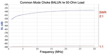

Finally, how does the choke balun perform for throughput:
This diagram shows that the return loss of the balun is better than about -40dB across the given spectrum. This translates to an almost 1:1 SWR across this entire spectrum.
And now, let’s compare it with the „commercially” built choke balun I happened to purchase at the HAM Radio Conference at Friedrichshafen:
It is evident, that my home-brew choke balun is as good as the professionally built balun, or even slightly better.
